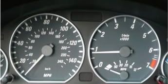

Non-ZHP instrument cluster (white needles and 6500 RPM redline):
http://img.photobucket.com/albums/v1...e.jpg~original

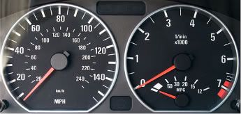

ZHP instrument cluster (red needles and 6800 RPM redline):
http://img.photobucket.com/albums/v1...d.jpg~original

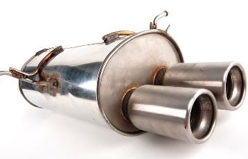

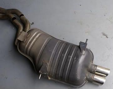

Question: Wait, I thought the BMW Performance exhaust system and the BMW Performance Package (ZHP) exhaust system were one and the same. They're not?
Answer: they are not. You can see pictures of them below. What's more, they have different part numbers, too. The ZHP exhaust system is part number 18-10-7-919-236 (18107919236) while the BMW Performance system is identified by BMW part number 18-10-0-429-614 (18100429614). As you can see from the pictures, the BMW Performance system is comprised of a muffler and exhaust pipes (we call these two parts the rear section). Clamps are also included, so that you can connect the BMW Performance rear section to the factory mid section.
Stock ZHP exhaust:
http://img.photobucket.com/albums/v1...1.jpg~original
BMW Performance exhaust:

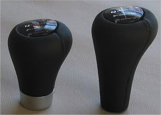

Question: Is the shift knob in the ZHP 330 different than the one found in the standard 330?
Answer: Yes. The ZHP got a weighted (and shorter) shift knob that is highly sought after. It's not unusual to see people put ZHP shift knobs on their non-ZHP BMWs.
ZHP shift knob on the left and stock shift knob on the right:
http://img.photobucket.com/albums/v1...k.jpg~original

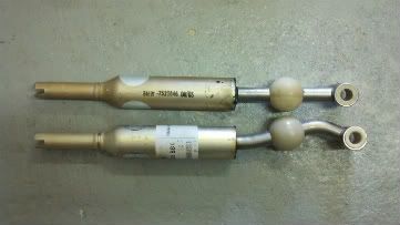

Question: Is the ZHP short shifter the same as the BMW Performance short shifter?
Answer: No. Notice the curve and the distance from the ball center on the BMW Performance short shifter.
Picture of the two short shifters (ZHP on top; BMW Performance on bottom):
http://img.photobucket.com/albums/v1...r.jpg~original
Note that the short shift levers were upgraded for both the ZHP and the BMW Performance at some point. Therefore, you can find two part numbers for each.
ZHP short-shift lever: 25117543187 (newer); 25117523846 (older).
BMW Performance lever: 25117528881 (newer); 25117522917 (older).

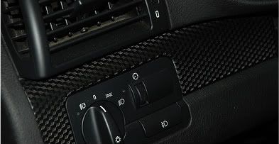

Question: I've seen two different interior-trim styles in the ZHP. Which was standard and which was the option?
Answer: The 330 ZHP comes standard with black cube trim. The silver cube trim was the option. And this note: when you look at the black cube trim closely (in person), you'll notice that there is quite a bit of purple color in it.
Black cube trim:
Silver cube trim:

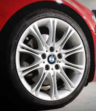

Question: What are the stock sizes for the 135M wheels that come on the ZHP?
Answer: They are 18x8 in the front and they are 18x8.5 in the rear. The front wheel's offset is ET47 (named IS47 on the wheel itself). The rear offset is ET50 (named IS50 on the wheel itself).
135M wheels:
http://img.photobucket.com/albums/v1...3.jpg~original

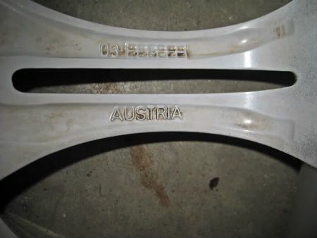

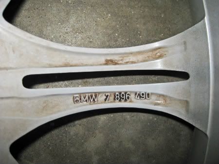

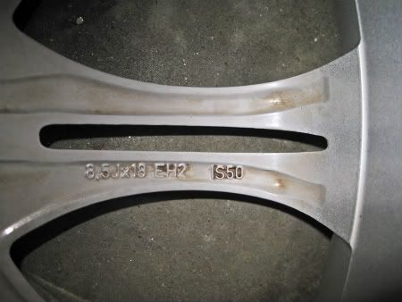

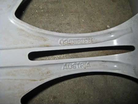

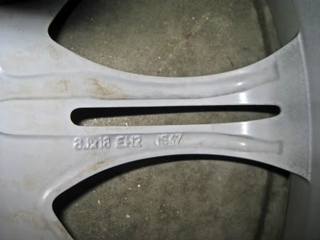

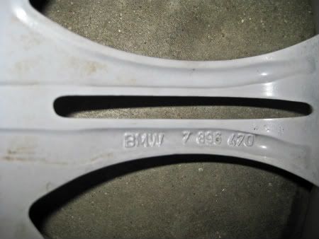

Question: how can I tell a fake 135M wheel from a real one?
Answer: a real ZHP wheel will have a BMW stamp on the inside (backside) of the spoke. Additionally, it will have the part number stamped on the wheel as well (see previous part numbers). A front 135M wheel will have an offset of IS47 on it, while the rear wheel will have a stamped IS50 on it. See pictures below.
Front 135M wheel:
http://img.photobucket.com/albums/v1...2.jpg~original
Rear 135M wheel:
http://img.photobucket.com/albums/v1...6.jpg~original
http://img.photobucket.com/albums/v1...5.jpg~original
http://img.photobucket.com/albums/v1...4.jpg~original

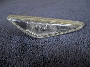

Question: How about the sidemarkers? Some are amber (orange) while others are clear. Why?
Answer: sedans got amber sidemarkers. The coupes and convertibles, meanwhile, got clear sidemarkers. What's more, the shapes of the sidemarkers are different. See the pictures below for an example.
Sedan sidemarker:
Coupe and convertible sidemarker:
