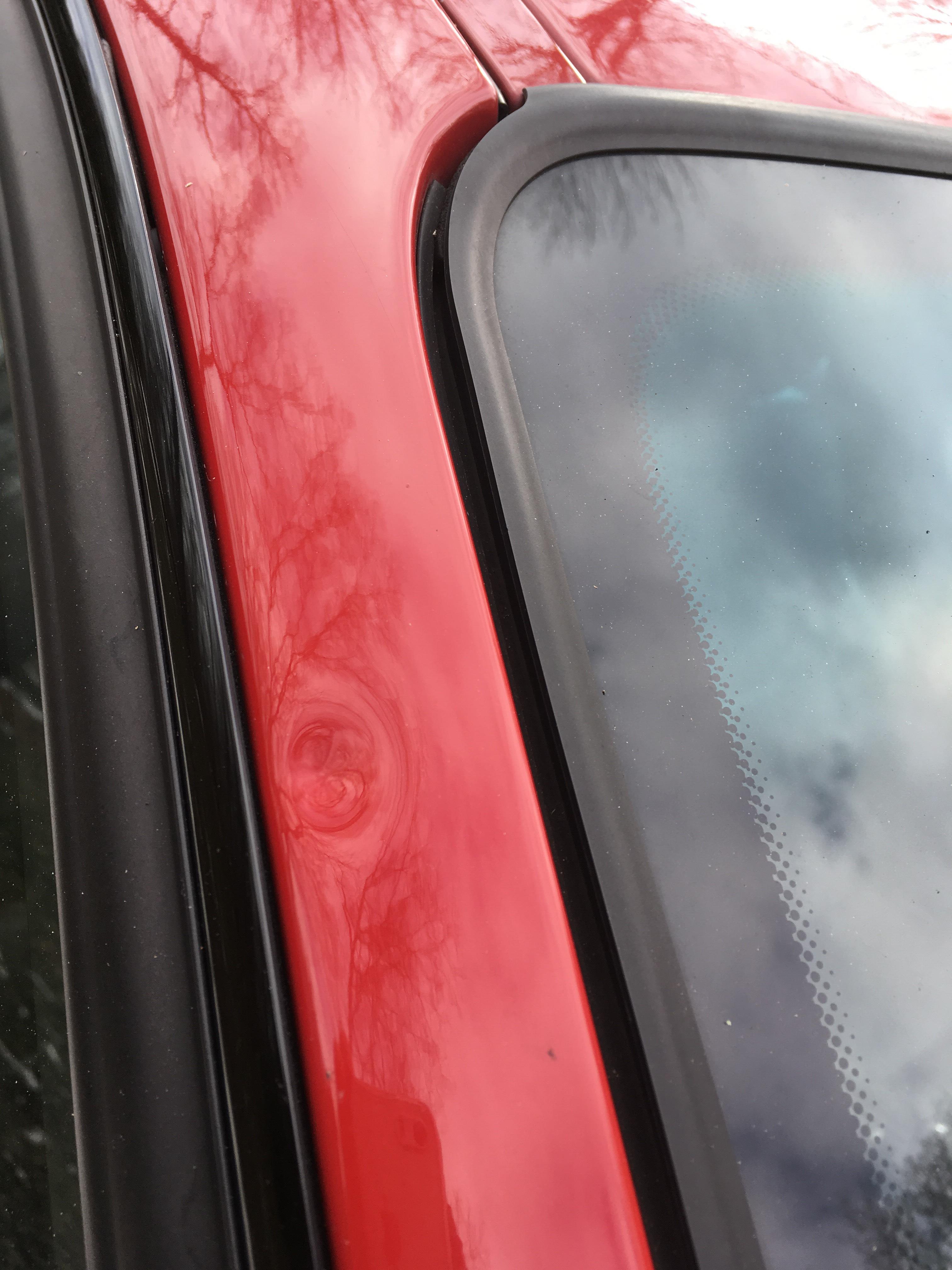

Found a dent on the A-pillar (right side). Given its location, are these PDR-able? luckily paint did not chip
Attachment 29443
Never know until you ask. They can do some pretty amazing things if they're good..,

I'm sure there are some PDR people who will say they can't. Honestly I'd call a higher end dealer nearby (someone like Porsche comes to mind) and ask who they use. They're not going to tell some guy who dropped $150k on a 911 "sorry bud, you're just going to have to live with a dented A pillar."
